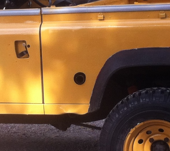

| Over next couple of days I will install a new exhaust. I decided to change the exhaust layout though which had the exhaust do a somewhat pointless loop into the space behind the rear axle where a rear fuel tank would go. I may fit a Td5-style rear tank to extend the range or fit a storage box into that space that would extend down from the cargo area.
So I ordered a 200 Tdi front down pipe and the rest from the silencer back is the 300Tdi system that exits at the back corner. I don expect to have any real challenges mating the pieces up but may have to fabricate some mounting points for the hangers.
Once that is all done I will have to repair the sloppy hole cut in the quarter panel where the piece-of-crap side exit exhaust was mounted.

| Started fitting the new exhaust system yesterday. The 200 Tdi front down pipe mated just fine with the 300 Tdi silencer. The rear tailpipe section ended up being about 250mm too short. Not bothered as this allows me to insert a flexible section ahead of where the pipe crosses the rear axle. Might come in handy if any extreme axle articulation over rough ground forces contact with the exhaust pipe. I had to fabricate and modify a few hangers, but nothing complicated. There was definitely a big difference in tube diameter and silencer size between the new and the old. Pumba should breath easier and run much quieter now. | |
